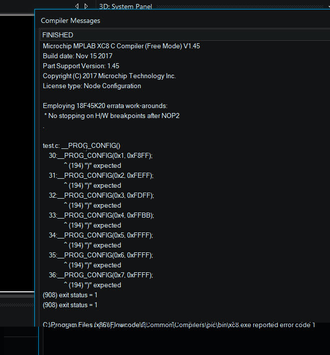

Error from Pickit 44pin demo template only with FC8 ok on FC7
Target folder: C:\FLOWFI~1\pic16
Source name:   C:\flowfiles\pic16\dem44template.fcfx
Title:         Microchip - DM164130-4 PICKit 44-Pin Demo Board
Description:   The default microcontroller for this template board is the PIC18F45K20, and is configured to
               operate from the internal clock, at a frequency of 16 MHz.
               It features;
               1x Micro-switch; RB0
               8x LEDS; RD0-RD7
               1x Potentiometer; RA0
Device:        PIC.18F.Microchip PICkit 44Pin Demo Board
Generated by:  Flowcode v8.0.0.6
Date:          Saturday, May 26, 2018 23:32:37
Users:         1
Registered to: stevebeale
License key: BWRNN3
   NOT FOR COMMERCIAL USE
http://www.flowcode.co.uk
Launching the compiler...
C:\Flowcode\Common\Compilers\pic\bin\xc8.exe  --chip=18F45K20 "dem44template.c" --MSGDISABLE=359,1273,1388
Microchip MPLAB XC8 C Compiler (PRO Mode) V1.45
Build date: Nov 15 2017
Part Support Version: 1.45
Copyright (C) 2017 Microchip Technology Inc.
License type: Node Configuration
Employing 18F45K20 errata work-arounds:
* No stopping on H/W breakpoints after NOP2
dem44template.c: __PROG_CONFIG()
    35:      __PROG_CONFIG(0x1, 0xF8FF);
                              ^ (194) ")" expected
    36:      __PROG_CONFIG(0x2, 0xFEFF);
    37:      __PROG_CONFIG(0x3, 0xFDFF);
    38:      __PROG_CONFIG(0x4, 0xFFBB);
    39:      __PROG_CONFIG(0x5, 0xFFFF);
    40:      __PROG_CONFIG(0x6, 0xFFFF);
    41:      __PROG_CONFIG(0x7, 0xFFFF);
(908) exit status = 1
C:\Flowcode\Common\Compilers\pic\bin\xc8.exe reported error code 1
FINISHED

Hi Steve,
Sorry that you are experiencing issues. To start with, we'll try and resolve your issue with compiling to PIC16 devices:
There are two things we must check initially. Could you confirm the following for me? (assuming that your compiler is installed in "C:\Flowcode\Common\Compilers\pic16").

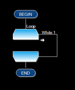

Hi DanielM.
Just in support of Steve,
I think there is an issue with the template board configuration and FCD file ,see below
just compiling a while loop in FC8 for the PIC low pin cont board results in an error reported for the Configuration word(this config is preset in FC).

Re: so many problems .
Post by QMESAR »
The same apply for the PicKit 44 Pin count Board it seams there is an issue with all the Template board configurations
Thanks for letting us know, it was the order of code in the definition file.
I've now fixed the "44Pin Demo Board" and "Low Pin Count Demo" devices and pushed the fix to the updates system.
Are there any others you've spotted with this problem?

S�trakMotorDriver6l�_20180628-2210.c:1279:28: error: macro "SET_PORT_MASK" requires 3 arguments, but only 2 given
S�trakMotorDriver6l�_20180628-2210.c:1279:3: error: 'SET_PORT_MASK' undeclared (first use in this function)
S�trakMotorDriver6l�_20180628-2210.c:1289:30: error: macro "SET_PORT_MASK" requires 3 arguments, but only 2 given
S�trakMotorDriver6l�_20180628-2210.c:1293:30: error: macro "SET_PORT_MASK" requires 3 arguments, but only 2 given
S�trakMotorDriver6l�_20180628-2210.c:1304:28: error: macro "SET_PORT_MASK" requires 3 arguments, but only 2 given
S�trakMotorDriver6l�_20180628-2210.c: In function 'FCM_initial':
S�trakMotorDriver6l�_20180628-2210.c:1937:2: warning: passing argument 1 of 'FCD_09b81_AutoVersionID1__GetDate' discards qualifiers from pointer target type
S�trakMotorDriver6l�_20180628-2210.c:1005:6: note: expected 'MX_CHAR *' but argument is of type 'volatile MX_CHAR *'
S�trakMotorDriver6l�_20180628-2210.c:1940:2: warning: passing argument 1 of 'FCD_09b81_AutoVersionID1__GetTime' discards qualifiers from pointer target type
S�trakMotorDriver6l�_20180628-2210.c:992:6: note: expected 'MX_CHAR *' but argument is of type 'volatile MX_CHAR *'
S�trakMotorDriver6l�_20180628-2210.c: In function 'FCM_SEND_Bluetooth':
S�trakMotorDriver6l�_20180628-2210.c:2745:2: warning: passing argument 1 of 'FCD_047b1_Bluetooth__SendString' discards qualifiers from pointer target type
S�trakMotorDriver6l�_20180628-2210.c:1354:6: note: expected 'MX_CHAR *' but argument is of type 'volatile MX_CHAR *'
Error returned from [xc16-gcc.exe]
C:\Program Files (x86)\Flowcode\Common\Compilers\pic16\batchfiles\pic16_C30_comp.bat reported error code 1
FINISHED
