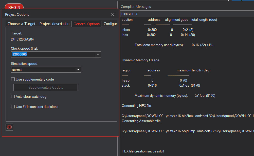

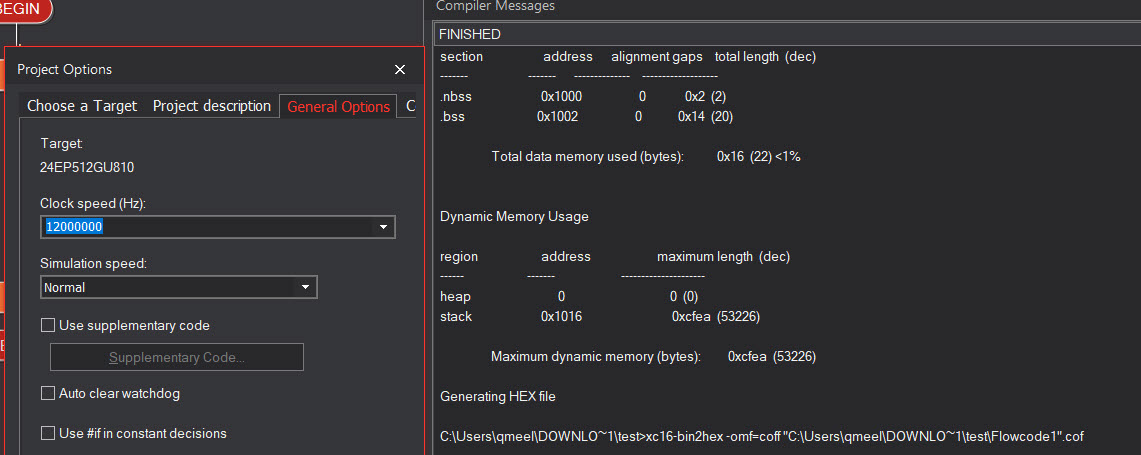

Both these chips compile just fine fore me in both FC7 and FC8
