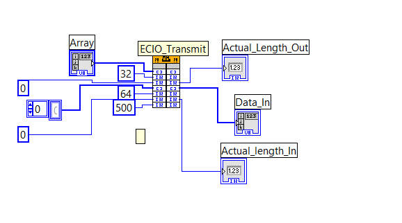

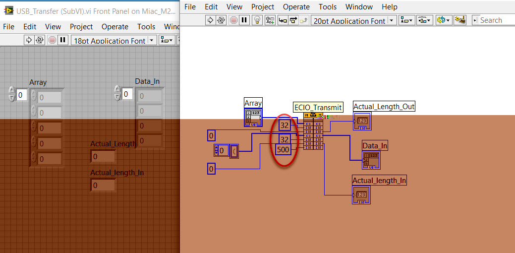

I had time today to try out the above suggestions unfortunately with no Luck
(1) If I set both parameters in the dll call to 64 then I am notable to send anything out from LV nothing works.
(2) if I set the outgoing parameter lengt back to 32 bytes and the incoming to 64 then I can send the original array to the MIAC I then see that I receive
the 36 bytes(just tries 36 need 64 at the end) send from MIAC to LV the incoming terminal of the dll call I wired to an indicator and it shows me the 36 bytes However every thing after the 32 bytes is always zero(0) .I think the MIAC USB component does not populate the bytes above 32 with data
I hope we can find a solution to this ,As always I appreciate your help and info.
:D
Please note the array length is not set corruptly here I only use the pic to show the indicators for the in and out length

Ben this is all working fine and the product is wortking in the field however
I have to send several packets now because if the data lenght is more that 32 bytes you always only receive 32 bytes on the PC side
I have tried to change the dll settings as you suggestet before but that does not help althought the microside is setup by MM to do 64 bytes packets.
you will see I posted a dll screen printz set at 64 bytes :D
so now instead of sending 64bytes I send 32 and trhen again 32 for example .
Peter
Re: MIAC P18
Hi Peter,
Does it make any difference if the outgoing is also set to 64. In your screenshot it shows you trying to read 64 but write 32 I believe. Probably won't make a difference but you never know :wink:
Otherwise you may have to live with 32 bytes for now until we have more time to investigate more thoroughly.
