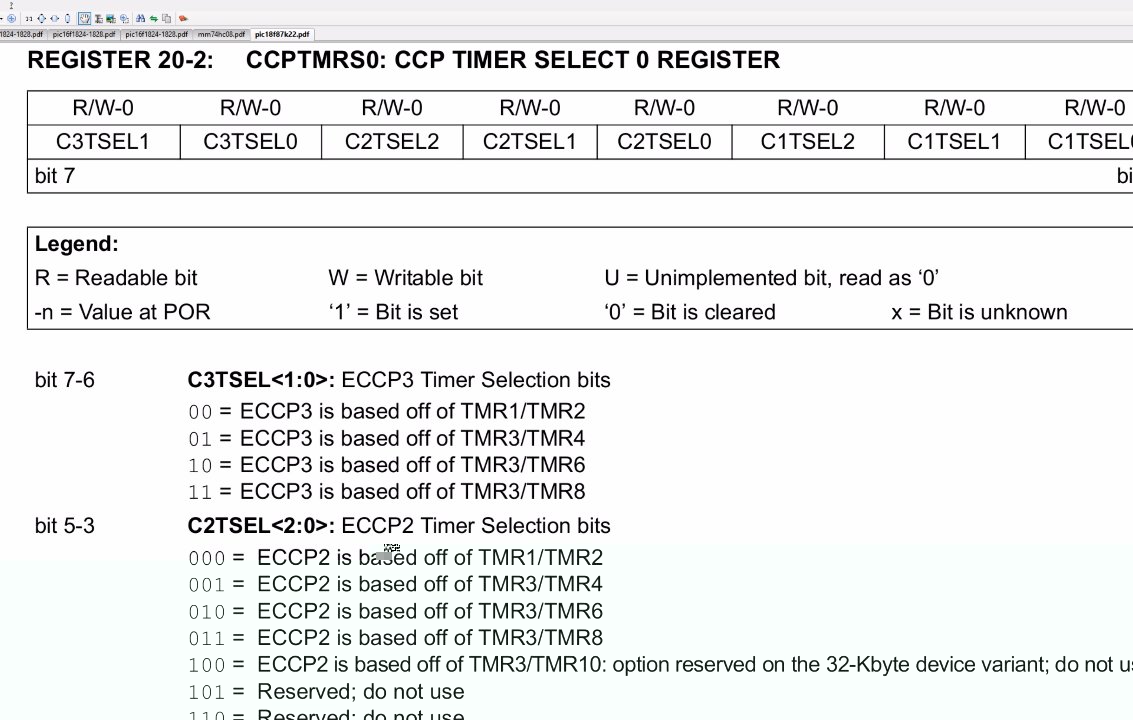

Hello dears !!!
There is a problem with the selection of the timer in PWM tools
pic18f67k22 controller

CCPTMRS0
