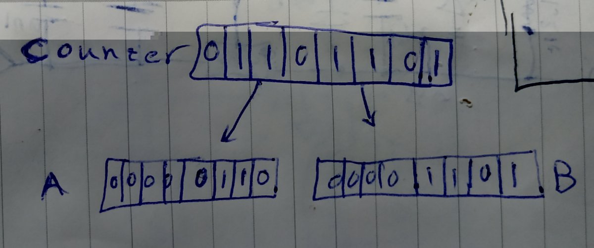

How can use the value stored in variable for addressing or copy in two other variable like the attached file
Help for Using value of variable

I would do something like this.
A is equal to counter bit shifted right by four places and then masked with 0b00001111
B is equal to counter masked with 0b00001111
Counter = 0b01101101
A = (Counter >> 4) & 0x0F
B = Counter & 0x0F

There are many ways to crack a nut, I think I'm missing the bigger picture of what you're actually trying to do.Thanks, but this is the only way?
If it's split a byte up into two nibbles then my code is probably as efficient as you can get.
I simply provided the counter = line of code as example of how to initialise the counter variable in binary if you need to.Counter value is not already known
Again I'm not really sure what you mean by this.What about addressing?
