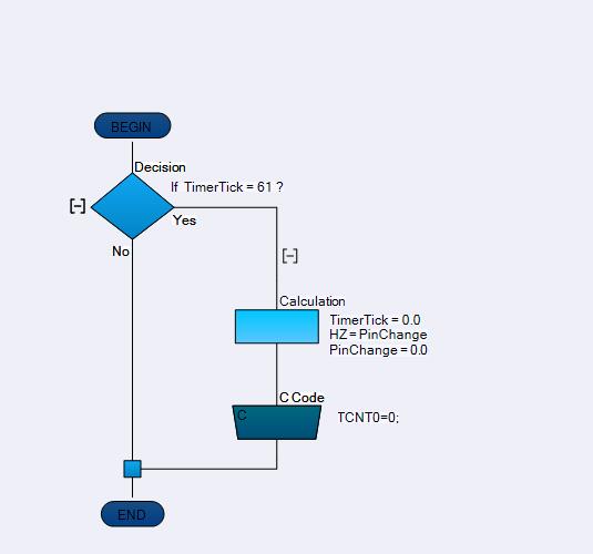

Your interrupt routine is incorrect too...
Things only get changed if TimerTick = 61??? but TimerTick is never incremented. In IOCB PinChange is incremented (edit - This is counting the frequency - increment TimerTick in the timer interrupt) .
You also are using floats (PinChange = PinChange + 1.0 for example) which may cause grief for some values.. PinChange et al are integer values so use an integer increment.....
And that ClearDisplay makes for an unpleasant viewing experience.

Good spot as I did not even look at the timer interrupt routine.mnf wrote:Things only get changed if TimerTick = 61??? but TimerTick is never incremented. In IOCB PincChange is incremented.

So your saying I need to add a counter to TimerTick? Would I add that to the interrupt routine?mnf wrote: Things only get changed if TimerTick = 61??? but TimerTick is never incremented. In IOCB PinChange is incremented (edit - This is counting the frequency - increment TimerTick in the timer interrupt) .
Or is that "edit" saying otherwise?
