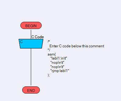

Just needing to get a little asm in for an ATTiny85 project - and I can't figure out how to define a label in FC.
Gives a
C:\Users\mn_fi\AppData\Local\Temp/cc5Ko2yh.s: Assembler messages:
C:\Users\mn_fi\AppData\Local\Temp/cc5Ko2yh.s:564: Error: symbol `labl1' is already defined
error message...
Any ideas?
Re: Avr ASM and Flowcode 8
Hi Martin,
The connection point icons create labels and gotos without using assembler. Assembler in AVR is very nasty unlike PICs and not something I've ever really delved into.
