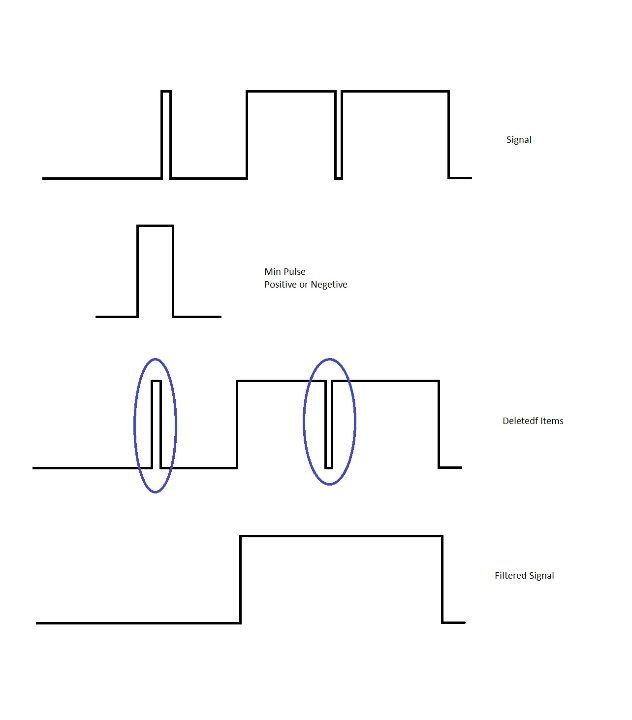

Below is a short depection of what I am looking to achieve. This is basically a signal coming of of a comparitor. I had the raw signal going through a low pass filter before entering the comparator but I was adding too much delay on the filtered signal. So I reduced the value of the cap on the filter and now I am seeing something like below which needs to be cleaned up.
I have also attached a short program with the parameters setup on how I get the pulse length.

Hello Everyone
I seem to be struggling with this... It does sound simple, and perhaps I am making it more complicated than it needs to be.
I have attached a program I have done this morning (I was hoping not to as I wanted you guys to look at it from a fresh perspective). It seems to work maybe 97% of the time, but now and then I get something going wrong.
Any help is appriciated...

I think I have got this done now - seems the problem I was having was some sort of debouce where the IOC pin now and then jumped through twice. Was very odd as this was not shown on the scope. This caused the IOC macro to run through twice incrementing the variable. This was resolved by saving the previous reading into variable and comparing it to the new one (if there was a change).
