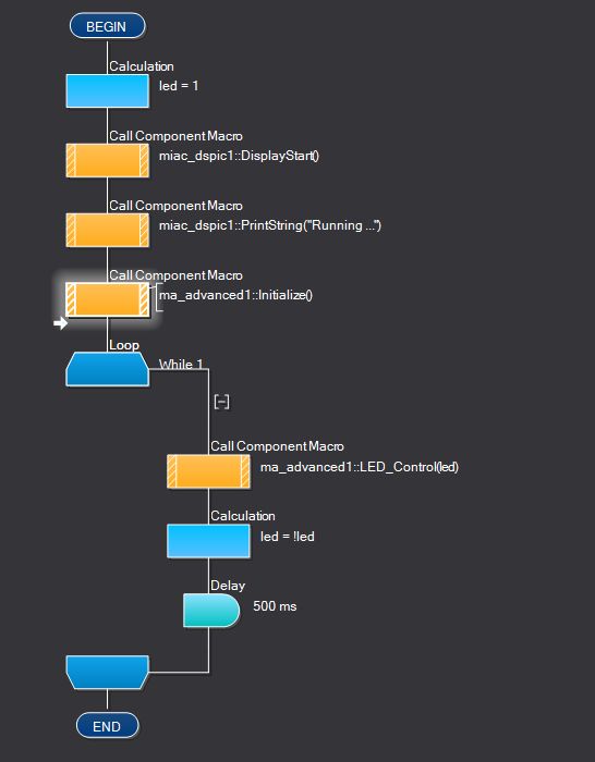

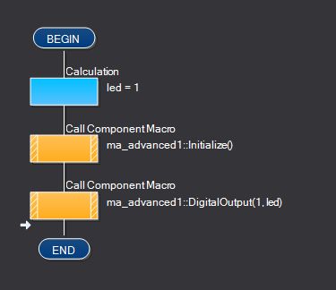

I have a strange issue with the advanced expansion module, I keep getting an error:
C:\Program Files (x86)\Flowcode\Common\Compilers\pic16\batchfiles\pic16_C30_comp.bat reported error code 1
When I try the example file Leigh sent before it works perfectly, the minute I take out all the references to the expansion module (initialize and Digital output macro) and re-compile it, it compiles 100%, do you know why i would get this error and when I use the example code for the expansion module it works 100%?.

Running the code below on its own run perfectly with no errors

Could you post the project that gives the error?
Re-creating the above images I do not get any errors
Leigh

When you use Expansion modules, the project target needs to be "MIAC (dsPIC) System"
