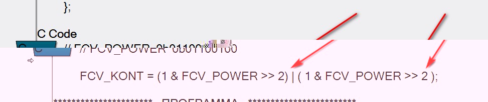

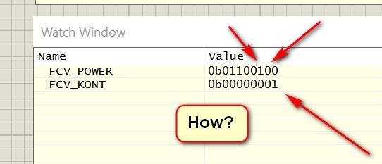

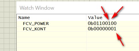

Can't compare the bits of the variable...
What am I doing wrong?

Hi Osta,
I think that's a good result.
0b00000001 and 0b00110010 =0b00000000,
0b00000001 and 0b00011001=0b00000001,
0b00000000 or 0b00000001=0b00000001.
Regards,
Lagoda

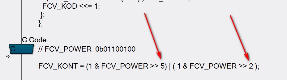

Hi Lagoda!!!
No difference.....

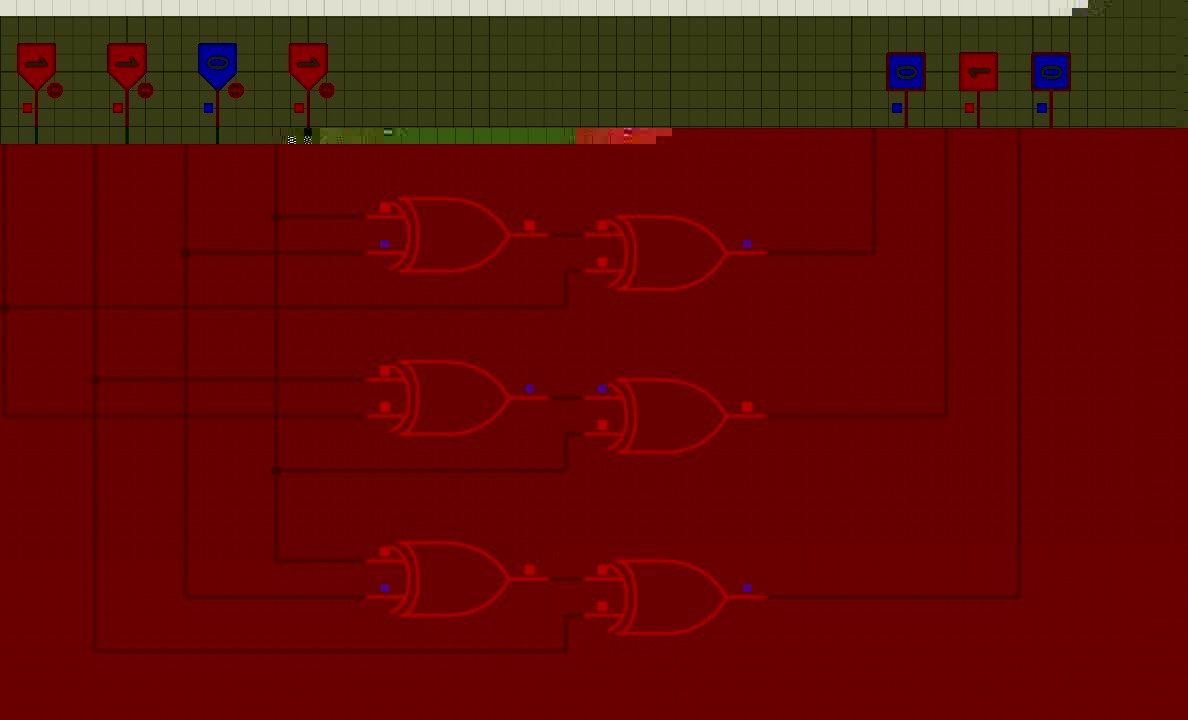

Ha
Ha
oo
oo

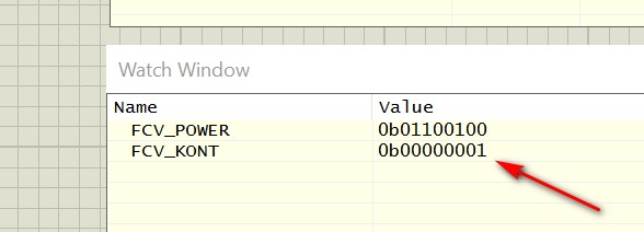

Re: Bit problems .....
Post by Osta »

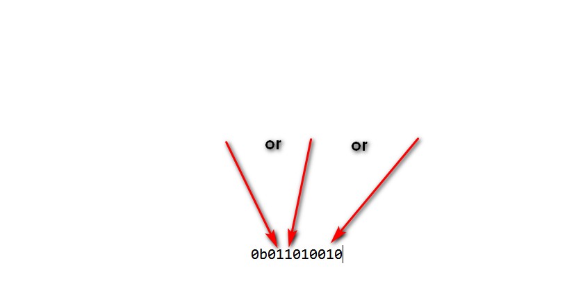

No difference...

Need to do two or
or
or

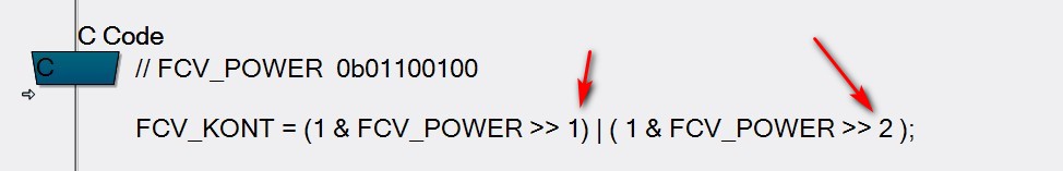

Variable check on several masks xor , or.
Lagoda
Posts: 170
Joined: Fri Jul 15, 2016 9:51 pm
Has thanked: 69 times
Been thanked: 61 times
Post by Lagoda »
Hi Osta,
I think the operator of XOR is "^". The operator of OR is "|".
Lagoda

Thank You, Lagoda!!
I realized my mistake...
