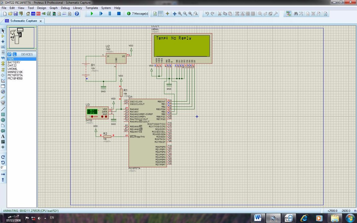

when i simulate DTH22 in flowcode 8 using PIC16F877A , it works very well .
but when i simulate DHT22 in protues 8.3 it doesn't work and DHT22 send no replay
the question is why it works in flowcode 8
but it doesn't work in protues 8
please help me
and if anyone send attachment files for that and thanks alot

it's working with flowcode 8 but
it doesn't work using protues 8
why?!!!!
pleeeeeese help
DHT22 PIC16F877A.fcfx
this is a flowcode file
(11.7 KiB) Downloaded 218 times
this is a simulation with protues8

I don't know if you solved this error (I'm struggling with this sensor now) No it doesn't work due to a flowcode error! The sensor is very slow and loads the program very much (enough to read at least 2sec from time to time)

Simulate in Flowcode and use real hardware to test your project,when it is not working in Proteus
go to the Proteus Forum with your license (for Proteus) and ask why it not working.
You also do realize Proteus 8.3 is very old you are 8 Proteus update versions behind :D
We do not support Proteus .
