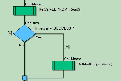

Local and global variables
In the Main loop you call the macro EEPROM_Read were you do assign the .Return to global variable RetVal.
However in Decision you do not check this value,
Instead you check the local variable .retVal = .SUCCESS
You have 2 variables with the same name: RetVal, .RetVal.
One is global and one is local.
The local one you write as .retVal or .RetVal.
I am not sure if it is a good practice.

Can I ask you Steven_SS,
Do you have any problems between the Modbus Master and Slave N1 on Mega2560?
I am not sure if it is important, but at Init stage I do the next:
I use the function: SetSlaveAddress(1) // if Slave ID = 1
I checked. I think we use this function only if we have to change/override the slave ID.
In the macro Comms you do it at the end of macro.
Should we do it only once by using the Modbus Slave properties->Slave address (1) ?
PS
When I tried to run the program with Ard Mega2560 board, I noticed the warning:
Uninitialised variable: RetVal

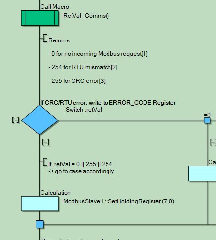

I noticed the same problem in the next:
Modbus slave checks the Master request and save it as local variable .status.
If .status = 1 (success) you assign this value as: .Return = .status
.Return is assigned to global variable RetVal (I am not sure why do you use RetVal again)
The Switch however uses the local variable .retVal.
- SlaveCheckRequest.jpg (42.74 KiB) Viewed 4328 times

That is strange how I had that global/local variable of return val. I altered that decision statement where it looks at the global RetVal now, thanks for picking that out! I solved the EEPROM issue. It was within the EEPROM_Write module where I zeroed out the reserved bytes, the simple numbering for that loop was off. Fixed those ranges and the EEPROM/EESAVE worked well.
