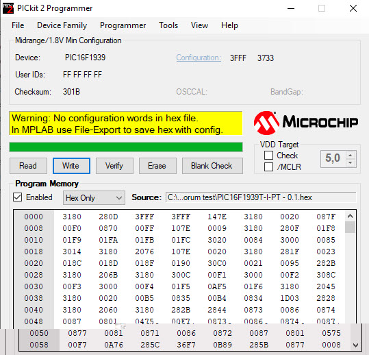

I’m making use of this Microchip; PIC16F1939T-I/PT
I have made a simple Flowchart to test If the ICSP is working. The Flowchart is working fine but when I upload the .hex file with PicKit2 I get this error: (see below)
I also don’t know if the configuration bits I have set are the good settings for this chip. I’m making use of the Internal Oscillator. Could someone please check this bits?
Thanks for your answers.
Frank

Suddenly the above error from PicKit2 goes away :-)
