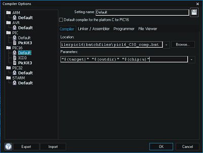

Oh Ben, just noticed...
Directory of C:\Program Files (x86)\Flowcode\Common\Compilers\pic16\batchfiles
04/05/2018 18:16 516 pic16_C30_comp.bat
04/05/2018 18:16 549 pic16_C30_compLarge.bat
06/02/2018 13:19 1,582 pic16_C30_link.bat
06/02/2018 13:19 1,660 pic16_C30_linkLarge.bat
22/05/2019 15:53 1,582 pic16_C30_link_ben.bat
Is this supposed to be used instead of the normal batch file for this MCU?
Cheers,
R
Re: dsPIC33EP256GP502 Resets if CAN Bus Component is Used
It's probably worth trying the large version of the compiler and linker using the compiler options to see if this makes a difference.
Let us know how you get on.

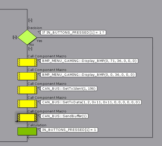

Thanks for the swift reply... All right, have done some debugging on my end... from FC8.
I have tried the latest Microchip's XC16 gcc compiler without luck, same results. Also with the pic16_C30_compLarge.bat instead, same problem.
Enabling the CAN Bus component (internal) alone doesn't produce any problems.
But when i send the buffer (SendBuffer) command, the MCU resets itself.
If I change the CAN Bus component from internal to external (SPI Software or Harware) and connect the PINS to unused pins of the MCU, then the program takes a long time to start (like 15seconds), but it does not reset....
If you can point out where I can do ICD3 debugiing (a guide), I can def. ru this alongside the code to find the culprit). This if you find it's a good idea... I can see what the program is really doing on hardware just before it reboots?
On the FC below, the culprit is SendBuffer... the previous 2 commands SetTXIdent and SetTXData don't cause the reset...
There is def. something going on with the CAN Bus component and this device. I have tried buffers 0, 1 and 2 with same results :-( Settings the
Thanks for your help!

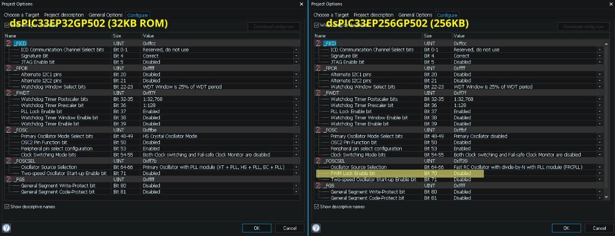

Any more ideas here? I tihnk I found what the problem is.. the 2 chips we use are of the same series dsPIC33EP32GP502 (32KB ROM) and dsPIC33EP256GP502 (256KB) have got different options in Flowcode when they should have the SAME ones:
The differnet flag is PWMLOCK .
WRITE-PROTECTED REGISTERS
On dsPIC33EPXXXMC20X/50X and PIC24EPXXXMC20X devices, write protection is implemented for the IOCONx and FCLCONx registers.... The write protection feature prevents any inadvertent writes to these registers. This protection feature can be controlled by the PWMLOCK Configuration bit (FOSCSEL<6>). The default state of the write protection feature is enabled (PWMLOCK = 1 ). The write protection feature can be disabled by configuring, PWMLOCK = 0 .
It seems this flag has nothing to do with our MCU... Our device is NEITHER dsPIC33EPXXXMC20X/50X NOR PIC24EPXXXMC20X .
It's dsPIC33EP256GP502. So this means there is definitely an issue with the FC8 configure bits...
Coudl you please have a look?

The problem here is that the config bits in FC8 for dsPIC33EP256GP502 (general purpose) are wrong (PWMLOCK shouldn't even be on the list at all), who knows what else is wrong here. FC8 assumes that the device is an MC device and not a GP one as it should be...
I will try to edit the C generated code to see if I get it to at least not reset... and reprt back :-(

PWMLOCK (1)
 1: This bit is only available on dsPIC33EPXXXMC20X/50X and PIC24EPXXXMC20X devices.
This is the problem. FC8 is generating C code that is not for this device. I have tried many combinations of forcing the bits from FC8.
One fo the many I have tried
