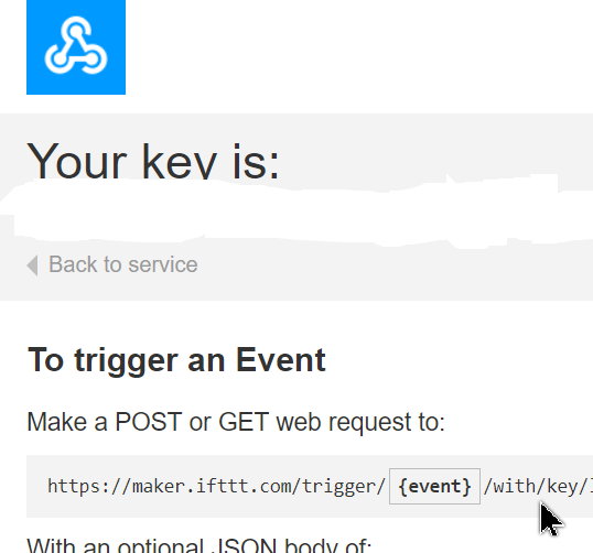

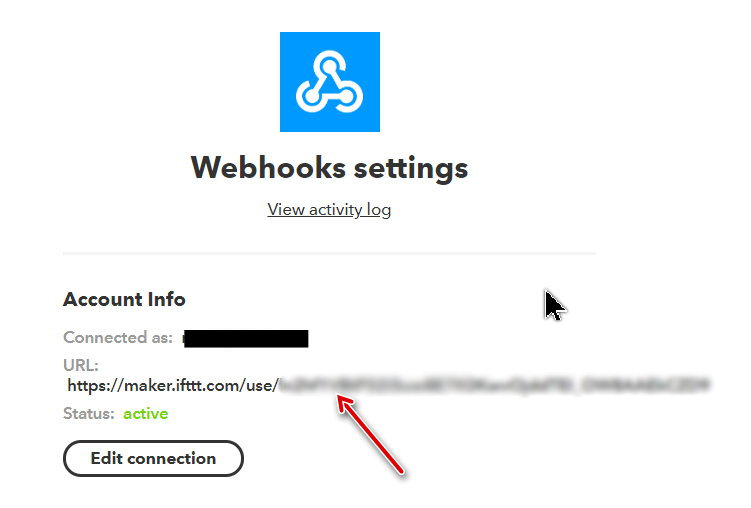

6) You now need the web address to access to fire your event. (This is where I struggled for a while!) Click on WebHooks (top Left My Applets -> Web Hooks ->) then Settings (top right)
7) Select the URL and then right click and Goto....
Now you'll have a 'Your Key is:' and a Post / Get web request address which is what you need
8 ) Copy this! You need to replace {event} with the event name you used way back in step 2 (I used plug_on and plug_off for my two events)

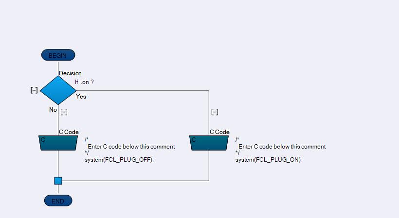

9) Use and enjoy. I used a raspberry pi and 'curl' in a system command in a C block. I created a macro SwitchPlug(bool on):
Where PLUG_ON and PLUG_OFF are local constants set to
"curl https://maker.ifttt.com/trigger/plug_on/with/key/long-key-in-here-you-will-have-your-own"
and
"curl https://maker.ifttt.com/trigger/plug_off/with/key/long-key-in-here-you-will-have-your-own"
Now in my flowcode I can do SwitchPlug(true) - to turn on and SwitchPlug(false) to turn off..
(I could have saved a smidge of memory by building the strings at run-time, but on the Pi memory was not an issue)
