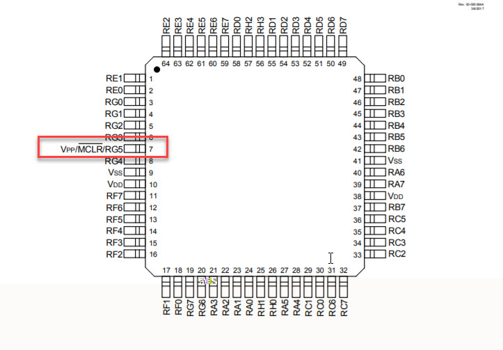

And how does RE3 and RG5 differ from the 18F67K40? RE3 works well as an output.

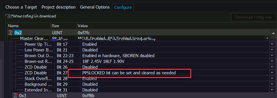

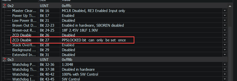

HI,
I would change the configuration settings for PPS from allow once to allow as needed
seokgi

Post by seokgi »
I ran as you advised but it still doesn't work.
  ~ MCLR doesn't seem to be related to RE3, but requires configuration in Project Options.

well I am not sure what is going on here however in my understanding of the Datasheet MCLR is at pin RG5 and not RE3 as in the FC definition file and it seems one UART is using RE3

I think the same thing. I'm waiting for a quick fix from Matrix.
