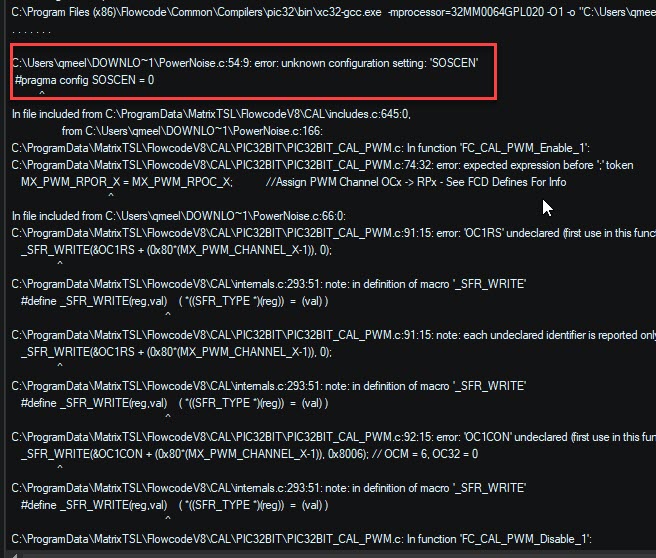

I don't think the compiler problem has been solved. I was thinking about doing a project with this processor. I think I'm going to give up.

Hi .
In my opinion it is not an Compiler problem but and definition file error

Many thanks and to you. I'll look into these issues for you and hopefully provide you with a fix. These are new devices for us and there are usually some teething issues with certain peripherals on new devices. Hopefully nothing too major.
