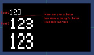

Hello Matrix team,
I must write a menue to a OLED 124x64. The font "0" is to little to read for older people. The next size is to big for long words. What I`m missing is a font like 7x10, if possible. So this font fill up the space between the fonts "0" and "2". Can you manage that? This will be very helpfully for me.
BYTE Font (Oled display):
Range: 0 to 31 - 0=5x8, 1=10x8, 2=10x16, 3=5x16, 4-31=Extended Sizes

GLCD fonts is something I've spent a fair amount of time thinking about. With your 7x10 font would you be happy using just this font or would you also need access to the 5 x 8 font on a single display.
Each font would consume an amount of your program flash area so adding more then one is possible but gets quite costly.
I've also used variable width fonts before and these can look really good but again at the cost of ROM space and additional code in the string printing routine.

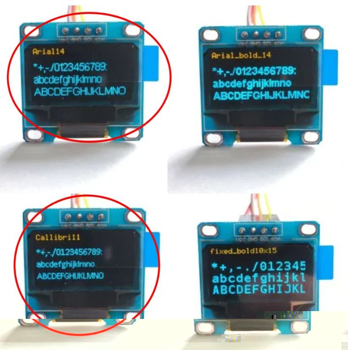

Hello Benj,
I found some pictures from the arduino with fonts in that size, I´m missing in FC8.
Please have a look to the size, where the pictures are selcted by a red ellipse.
Jorg
Jorg
