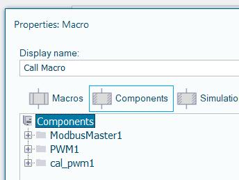

Re: UPDATE: PWM won't run in simulator
I saw that there are 2 PWM functions. One is in the "Creation" section and the other is in the "Output" section. I emailed Matrix and the reply was that they are the same (but you have to pay extra for the one in the Output section which is included with the Basic IO purchase).
I went ahead and purchased the BASIC IO, set up the Output PWM and it WORKS as expected. The screenshot shows the two different PWM's. The PWM1 is the Output PWM, and the cal_pwm1 is the "Creation PWM'.
I suspect the "Output PWM' creates a PWM using microcontroller resources and the "Creation PWM' was intended to use the PWM function in many of the PIC processors.
