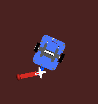

Hello Benj and sorry again!
The model has good addon mech but the objects do not follow the Allcode...
Bruno
Bruno
- (4.62 KiB) Downloaded 2961 times
- GIF.gif (59.35 KiB) Viewed 34334 times
Re: Model 3D et AllCode
Thanks for letting me know. It's working for me in v8 so could be down to how you have grouped things. I just selected the FA and everything else I wanted to move with it and grouped them together.
Can you attach your program so I can see your grouping.
here it is.
- Flowcode1_testmodel3d avec allcode.fcfx
- (14.64 KiB) Downloaded 708 times
Aha, thanks it's the logo commands that are not working with the group.
For now here's a prog that works
I'll get this fixed but it will probably be tomorrow if that's ok, I'm out of the office today.
