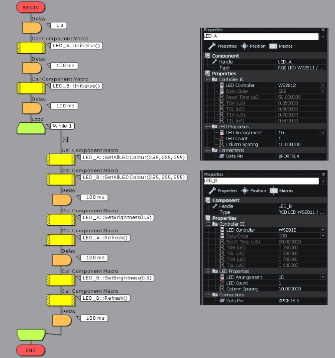

Hi guys,
We need your urgent help. We've got a very simple test program with 2x WS2812 LEDs, attached. We are trying to update 2x WS2812 LEDs without luck :-(
MCU: PIC32MZ1024EFE100 (Supported) and FC Version: 8.2.1.13
First to clarify, we get compiling error messages, but the HEX file is generated in the end.
D:\Projects\CASHAR~1\Products\ELECTR~1\U22BEL~2\FC8\CONTRO~1\CONTROL_PCB_V1_TEST.c:262:0: warning: "MOSIPIN" redefined [enabled by default]
 #define MOSIPIN LATBbits.LATB4
D:\Projects\CASHAR~1\Products\ELECTR~1\U22BEL~2\FC8\CONTRO~1\CONTROL_PCB_V1_TEST.c:183:0: note: this is the location of the previous definition
 #define MOSIPIN LATBbits.LATB5
D:\Projects\CASHAR~1\Products\ELECTR~1\U22BEL~2\FC8\CONTRO~1\CONTROL_PCB_V1_TEST.c:267:0: warning: "MOSIBIT" redefined [enabled by default]
 #define MOSIBIT 4
D:\Projects\CASHAR~1\Products\ELECTR~1\U22BEL~2\FC8\CONTRO~1\CONTROL_PCB_V1_TEST.c:188:0: note: this is the location of the previous definition
 #define MOSIBIT 5
Configuring more than 1x WS2812 LED in Flowcode breaks the whole program.
> Only LED_A is updating on hardware.
> LED_B NEVER gets updated on hardware (no output signal).
> If we disable in Flowcode all LED_A components, still LED_B doesn't get any output on hardware.
> The issue has to be related to the compiling error messages received as with 1x LED we don't get any compiling errors at all.
Can you please help? We are unable to move forward because of this :-( Our main program has got 20+ WS2812 LED components and also not working at all. Many thanks in advance!

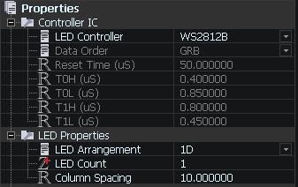

I have tried 6 concurrent Refresh() updates and all LEDs work perfectly well. I'm using interrupt routine for this.
Only thing to note for anyone else trying this out... the LEDs are WS2812B, timings on data Sheet should be 50us, 0.35us, 0.9us, 0.9us and 0.35us.
In order to get those times on hardware, the settings in FC need to be as follows:
Measured hardware output:
(148.27 KiB) Downloaded 2198 times
Just a question to you, can I tweak each LED for different timings or not yet? I need to hook up all 20x LED instances including the ones with ~1m cables and will get some feedback on that. So far for the LEDs on close PCBS it works perfectly well.

"C:\Program Files (x86)\Microchip\xc32\v2.30\bin\xc32-gcc.exe"
with same results :-(
Furthermore, if I remove the -O1 (optimization) flag for the compiler command line, it still doesn't work, with both FC8 and Microchip's xc32-gcc
