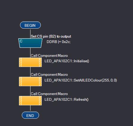

Just noticed a small bug in the Arduino (I've tested) implementation of AP102C component.
A simple single strand of LEDs connected to SPI (hardware) works AOK - if you remember to set B2 to output.
- But I noticed that one LED was not lit.
Rather than counting to 60 (ran out of fingers) - I reset the strip length to 10 - and only 9 LEDs are lit at the start of the strand.
Note that all the LEDs are functional - (setting the strand length to 61 lights all the LEDs although there are only 60)
There isn't a 'hidden' LED at the start of the strand.
The C code looks OK - for SetAllLEDColour and Refresh. (while FCL_INDEX < 10 - gives 0..9)
The Adafruit strandtest works correctly....

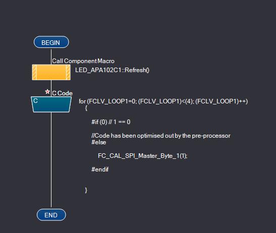

The cause of this is the lack of an end frame in Refresh()..
From the data sheet:
(125.43 KiB) Downloaded 906 times
So adding my own refresh macro which adds an end frame:
- and the correct number of LEDs now illuminated..

Not quite a complete fix - needs the bit-bang alternative too! Hopefully easy for Ben & co to incorporate.

Re: AP102 LEDs
Brilliant, Thanks for letting us know and well done for finding the cause of the problem.
I've added the End Frame to the refresh function now and pushed the fix to the update system.
