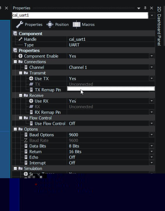

Hi Ben.
as you can see here the UART pins are unconnected and the option to remap shows zero options
Re: Pic32mz Uart broken.
Great spot, thanks for letting us know. Should be fixed now via the update system.
