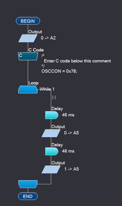

Gotcha, I did find something else strange. Just a simple delay loop about every second I get a glitch in the output.
You can see it on the scope trace.
And this is my program.
Any Ideas?

Looks like it's resetting, check watchdog timer setting

I turned it off and it does the same thing. Power is stable and good. Totally disconnected the programmer and it still does it.

I think I found it. It was the brown out detection. If I disable it it doesn't reset. Very strange.
