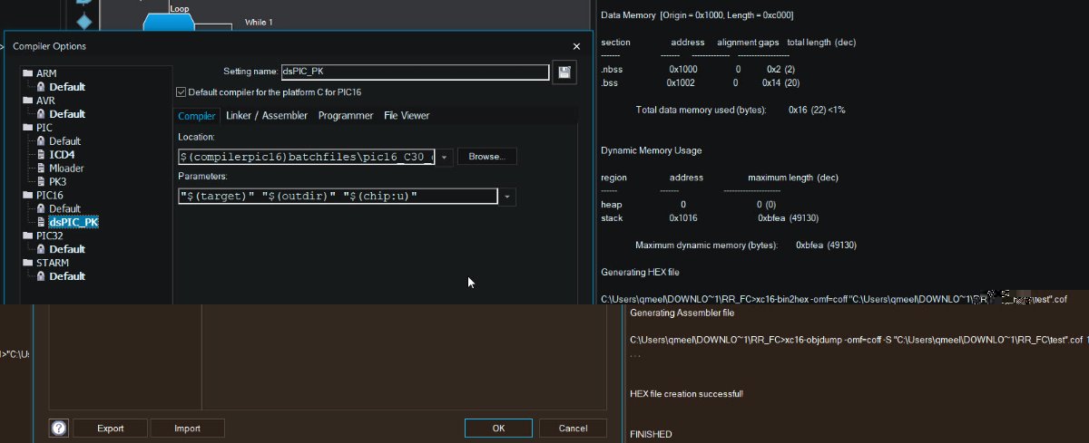

I am not sure about the compiler path settings as shown above by Ben and you confuse me as well
My XC16 compiler function well in FC with these paths
location
$(compilerpic16)batchfiles\pic16_C30_comp.bat
Parameters
"$(target)" "$(outdir)" "$(chip:u)"

Thanks QMESAR
Yes, I have same as you.
Looks like Ben might have made a typo with his copy'n'paste,
(we have a lot on at the moment, interesting new products)

Thanks to your help, the Compilation goes well. However, it does not apply when a new compiler is released. What should I do?
Thank you all for your help.
QMESAR
Posts: 1287
Location: Russia
Has thanked: 384 times
Been thanked: 614 times
Re: XC16 compiler setting. help me!!
Post by QMESAR »
No this never change even if there is an new version of the compiler
