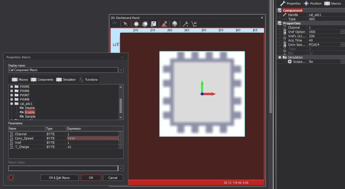

Hi everyone
I like to use the CAL_ADC component from the TOOLS menu.
However, I can't understand what value I should give to the Conv_Speed byte.
You could see that in the properties panel I've selected as Conv_Speed = PCLK/4 (24MHz/4 = 6MHz).
Should I give the value 4?
Best Regards FOTIS ANAGNOSTOU
Yes (the value is the ADC clock divider 1, 2 or 4)
T_Charge is the number of clock cycles for the sample time
Values can be 1,2,4,7,19,61,181,601 (Flowcode selects the nearest value if you enter any other value)
Vref is not used by the Enable macro

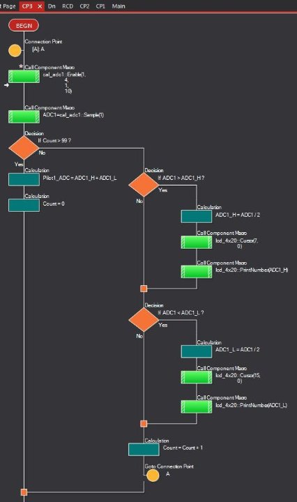

Now I try the ADC conversion to be based on a timer interrupt as you told me.
So when Timer 7 overflows, it calls the macro CP3 of which the first command is the "ADC_CAL Enable".
I try various rollover values of timer 7, as well as various configurations of ADC_CAL and values of averaging (variable "Count") having in mind the Nyquist criterion, to get trustable readings of the peak voltage of square pulse.
For a duty cycle, greater than 25% is easy.
For less than 25% it is difficult as I have big fluctuations up to 300mV.

If you are only using one ADC input in your project, you could call ADC_Enable once at the start.
Then only call ADC_Sample in your interrupt.
That will reduce the process time of the interrupt

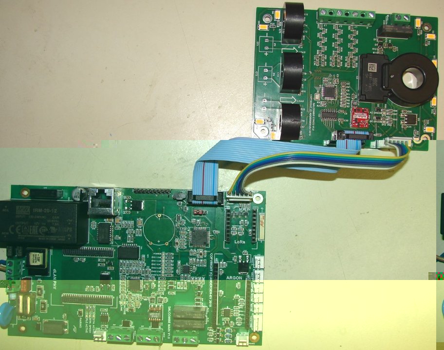

I really need the second ADC.
In my prototype PCB there are 4 ADC inputs, connected to STM32F303RE as follows:
1) Pilot1 IN = ADC1_IN1 (PA.0)
2) Pilot2 IN = ADC2_IN5 (PC.4)
3) Proximity1 IN = ADC3_IN1 (PB.1)
4) Proximity2 IN = ADC4_IN3 (PB.12)
Here a picture, it is a dual EVSE + Energy Monitor + RCM-B , with LoRa + WiFi + Ethernet communication
I agree with your proposed solution as I understand what said Ben.
I will try a C icon code, but I'm sure that will need your help :)

The Pilot signal is a square wave with a fixed F=1KHz, and only the duty cycle (Dn) and the Vpeak can be changed.
The only value that is needed by the application, is to get the Vpeak.
If you need the Vavg, you can calculate it later with: Vavg = Vpeak * F * T where F=1000Hz and T=0.001s * Dn / 100.
I found that to get stable readings yet with a very small duty cycle (e.g. lower than 10%), the minimum number of samples should be greater than 50.
For 50 samples the required time is 50 * TADC = 614us.
I have enabled the TMR7 interrupt, with rollover F = 10Hz, which calls the ADC macro.
Then with a "While count < 50" loop I get only the ADC_Hi value which corresponds to the Vpeak.
To the present, the readings on the LCD of my hardware are very good.
