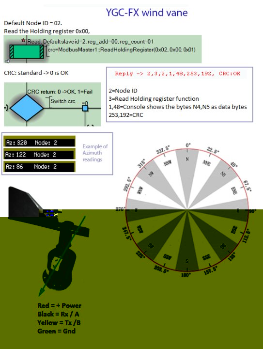

Re: YGC-FX =Slave 02, YGC-FS = Slave 01
I could move forward a bit by using the English manual.
The manual was sent to me by the Chinese seller (after a few emails to him).
The manual says about CRC:
01 Success, 00 Fail.
It didn't work.
Looks like 0=OK, 1=Fail.
I've got some results with:
Read Holding register 0x00, slave id=0x01, regi_n = 0x01.
And I have a question.
The bytes N4 and N5 have the data.
The manual say:
The sensor returns data 0x0026 converted to decimal 38, indicating a wind speed of 3.8m / s, with a decimal place.
How can I join two bytes and convert them to decimal?
It didn't work.
The manual say:

Re: Chinese wind YGC-FX and YGC-FS modbus id question
To join two bytes together you would do this.
IntVar = ( MSB << 8 ) + LSB
Which is a more efficient way of writing.
IntVar = ( MSB * 256 ) + LSB
If you're reading a Modbus register via the component then it's a 16-bit value already. The above is already done for you.
No conversion required between hex and decimal, to the micro they are the same binary value.
Create an int from lsb and msb
I am not sure which one is received first.
MSB should be 1st, isn't it?
And only after I add the LSB byte.
It is not easy to translate Chinglish manual to English.

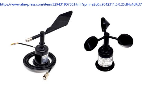

Re: Link to YGC-FX and YGC-FS
Re: send us a link if you find a good product.
The products I have are for weather station.
This is the link
https://www.aliexpress.com/item/3294319 ... 4c4dKO7DOu
This is the link

Re: Chinese YGC-FX and YGC-FS modbus Node ID question
Changing the device address is something only the manufacturer will be able to describe how to do. It may be set via jumpers or set via modbus commands or may not even be possible.
For modbus MSB is first and the CRC is automatically calculated for you.
Looks like you would perform a ReadInputRegister or ReadHoldingRegister command with the correct slave and register address and then use the GetResponseInt function to read back the 16-bit data with an Index parameter of 3 I beleive.
Here's a very basic example.
Thank you Ben
I have contacted Chinese manufacturer with node id write function question. I hope I will solve this problem.
Wind vane YGC-FX update
- ygc-fx_info.jpg (80.96 KiB) Viewed 5203 times
