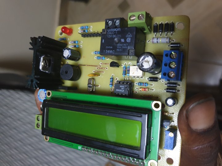

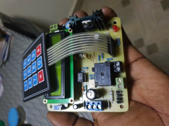

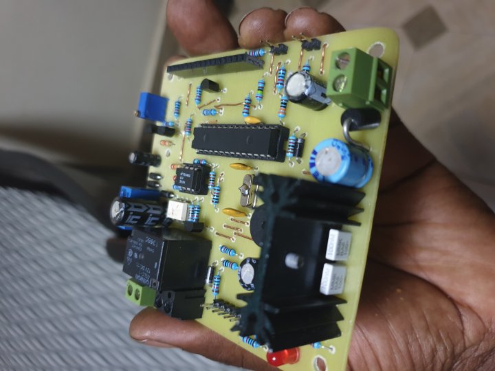

Many thanks goes out to medelec35, i always say its Educative to have you around and Yes it is also thanks to Benj,my project was a success.After i remade the PCB this time with an external oscillator it turned out perfect, you can hardly see a difference if compared with a real physical clock in-fact you can not see any difference ive run it for hours and its wonderful.I gave this device a name as SSD (System Service Dailer) ok You enter the hours on a keypad that you want a system to run and after those hours the system will be cutoff from power and request for servicing.I used the MCU eeprom to store hours used to keep that record even if power to the system is swtched off.There is a password requested before you can enter new service run time, you can enter hours from 1 hour to 9000 hours there is an option of timing only Minutes from 1 minute to 60 minutes also entered using a keypad after you have provided a correct password,you can also change the password as needed.I did the password thing in this project so that only the operator or engineer can change the service run time of any system. Check out the Pictures of my finished project will upload a video of it in action soon if possible and show how it works, guys Flowcode is intresting.

Hi Derrihj,
Your project sounds interesting and would love to see a video if it working and perhaps compared to a clock.
What tolerance crystal did you opt for?
It's a pleasure & glad I have helped.Derrihj wrote:Many thanks goes out to medelec35, i always say its Educative to have you around
