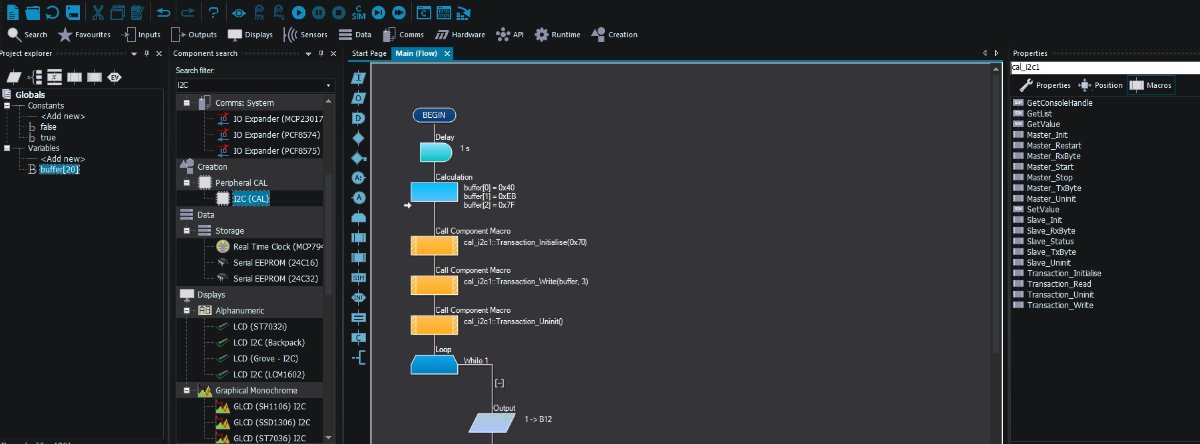

Update:
this is the screen of the i2c CAL component
I'm trying to send transactions but it doesn't seem to work.
