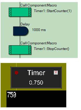

A few more questions please.
1. How can I test the timer1 (storage)?
I used the delay component to let timer do the counting.
However the result is a different from expected.
What is the reason?
2. Timer1 has own display.
This display shows the numbers with dot.
No units after numbers.
Is it in seconds?
What is the reason?
Is it in seconds?

Re: Timer (storage) compile error with Mega2560
The simulation will be a bit out, it relies on Windows timing to do the incremental tick and so will generally be a bit behind. On hardware it should be pretty bang on (probably more accurate then the delay).
0.750 = 0.75 seconds.
