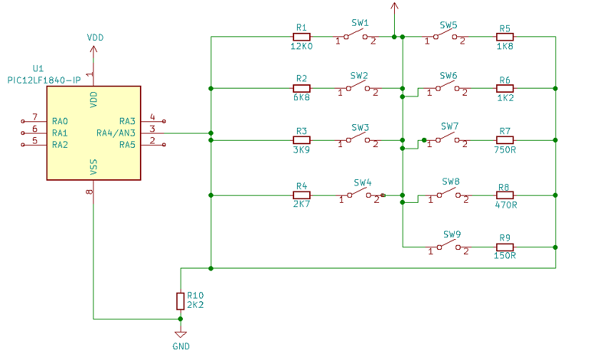

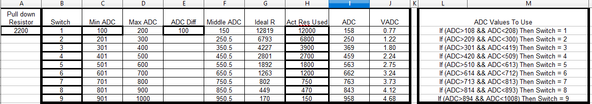

To do that, I have created a spreadsheet that will allow you to easily connect from 2 to 9 single pole switches, e.g tactile to a single analogue pin.
The spreadsheet should work with any free or paid for software.
For those who have not got such software here is a screen shot:
Required resistors for 2 to 9 Switches.png (37.54 KiB) Viewed 46475 times
All the if ADC values are dynamically changed, depending on resistor selection.

Circuit:
Schematic for 2 to 9 Switches.png (58.96 KiB) Viewed 46490 times
Note: Can only operate one switch at a time.

The other alternative is to use all the same resistor values e.g 1K2 in series, connected between +VDD & GND.
A high value resistor e.g 820K is connected between ADC pin and GND.
The ADC pin can then be connected to each series resistor junction via momentarily switches.
The disadvantage being very susceptible to electrical noise.
Therefore would strongly recommend using a decoupling capacitor across the high value resistor.

One query - there is some overlap in the checked values (<208 sw 1 >200 sw 2 for example)... This shouldn't pose a problem - button registered should map to first conditional statement...
Unless you just use consecutive if's (and nested is going to get a bit messy for 9 switches) in which case two switches could register?

Hi Martin,
Thank you for your query.
You are spot on!
I just did a calculation so the ADC was in the middle of two ranges which indeed could cause issues if not nested.
I have change the excel sheet so the start in the next value is 1 greater then the end of the previous value.
It does shift from the centre point but should cause less of an issue in the long run.
Updated both files
