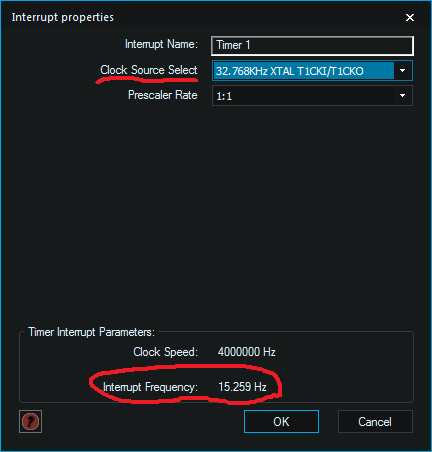

Also in the interrupt frequency section, interrupt frequency is created from the main source frequency. :?: :!: :?:
:arrow:

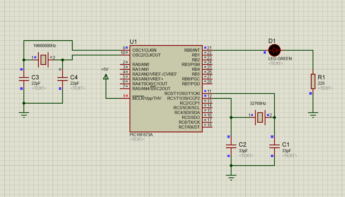

This is the schematic of my circuit:
:arrow:
I designed the same Flasher circuit for one second, but it didn't work
Re: Timer1 Does not work
You have the configuration setup for an 20MHz external oscillator but this is not supplied on the schematic. First concentrate on this and getting the 1 second flasher running.
Next the crystal across the T1 pins needs capacitors to ground on both of the pins, datasheet specifies 33pf.

Hello Ben
I made the changes you mentioned(In real hardware), but nothing happened again :( :( :(
:arrow:

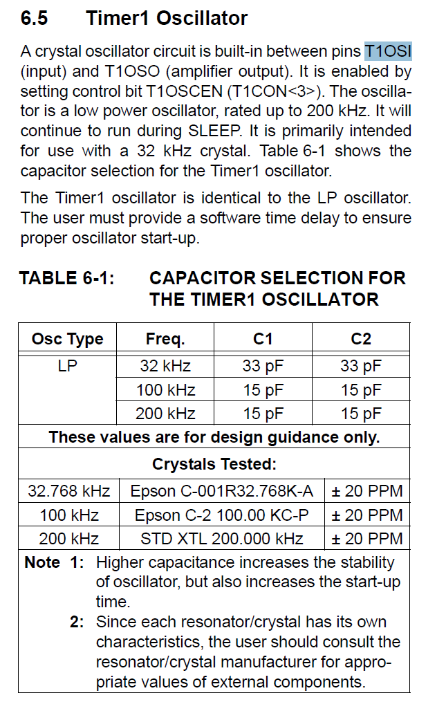

I acted according to the data sheet
:arrow:

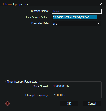

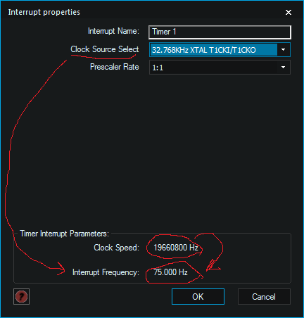

But in interrupt settings, the interrupt frequency changes with clock speed change,That shouldn't be the case :?: :!: :?:
:arrow:

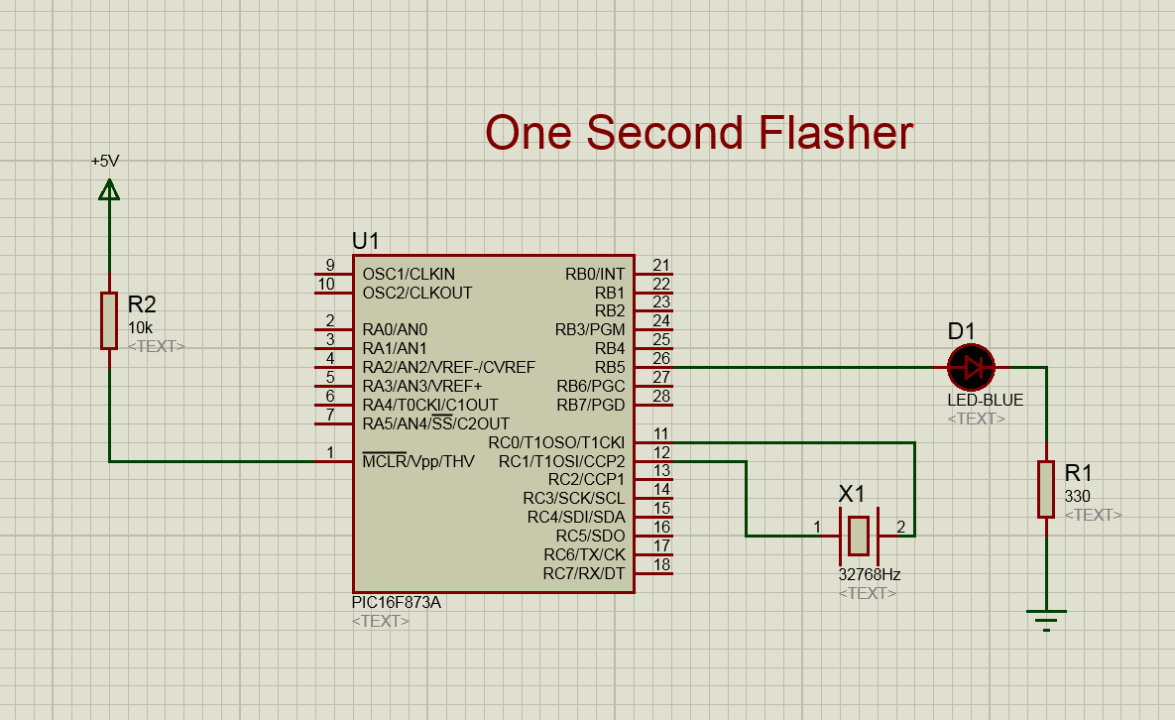

Is the one second flasher test now working? Nothing will work if this isn't working.
https://www.flowcode.co.uk/wiki/index.ph ... ED_flasher
The interrupt properties interrupt frequency is wrong and is not calculated correctly. Its a bug that has been there for a while. It basically cannot know the frequency of your external input and so treats it as off the main clock. This can be ignored and won't cause any problems.
