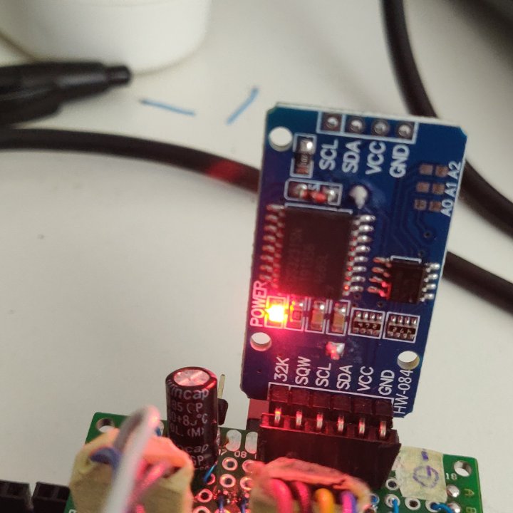

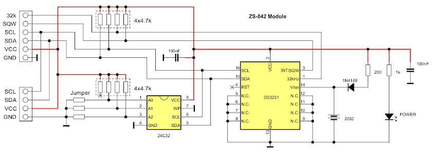

hello
I downloaded your code and I saw that it has many more functions, so I downloaded your library and copied it inside the component folder (correct?), but when on FC8 I look for DS3231 I can't find it. (what is the correct procedure?)
I use a card where a 24C32 type memory is also mounted which is not currently used
pull-up resistors are present
nothing else is connected to the I2C line
CR2032 is ok
thanks

Hi Martin
freq 32khz is ok
I tried to insert the reset macro after the initialisation but there were no changes on the operation.
I looked at the DS3231 datasheet and the 0x0E register seems to be commanded correctly
I try to buy another card maybe mine is broken and maybe we are going crazy for nothing, I will keep you informed
thank you
freq 32khz is ok
thank you
