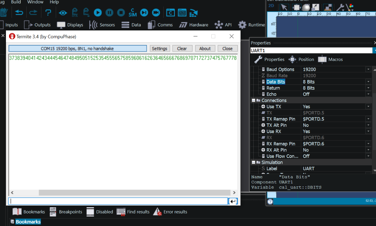

Attaches is the response from STM32 MCU's UART port. I get some junk characters instead of numerical data.

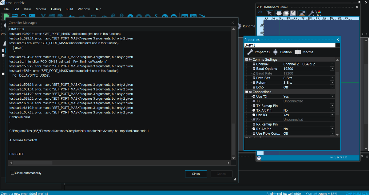

I have tried to build using USART2 port, but there is some error if I choose pre-configured USART or UART ports directly. If I choose software mode and I define the RX and TX pin manually then there is no error during compile. Below are some examples of pictures. Please help.
Karthick.
In the attached project you had not selected the Rx/Tx pins? ...

HI LeighM,
Thanks Again. Yes, you are right. I forget to select the port. I thought when I select the Channel 2 -USART2, Flowcode define the pins automatically.

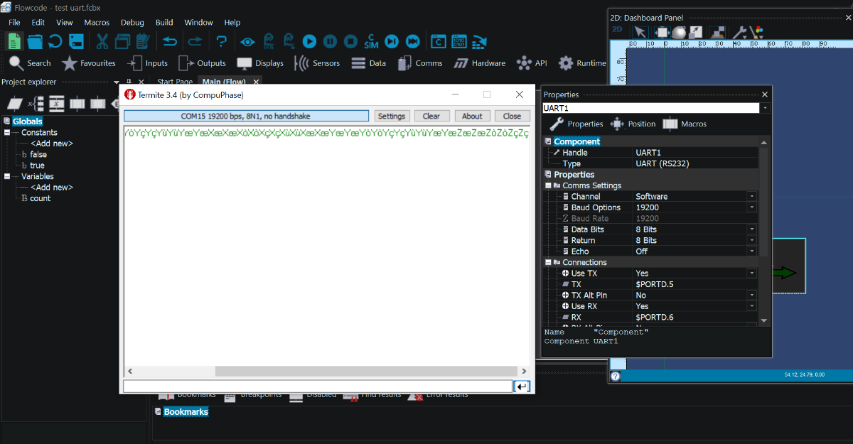

After defining the PD5 for Tx and PD6 for Rx and now working fine. But it is not working with software mode and manual define ports.
Is the Flowcode project "clock" speed correct for the crystal on your hardware?
I noticed it is set to 16MHz

When you try software mode, do you get anything at all? or do you get garbage, i.e. wrong characters?
Software mode will only work (be accurate enough) at lower baud rates.
