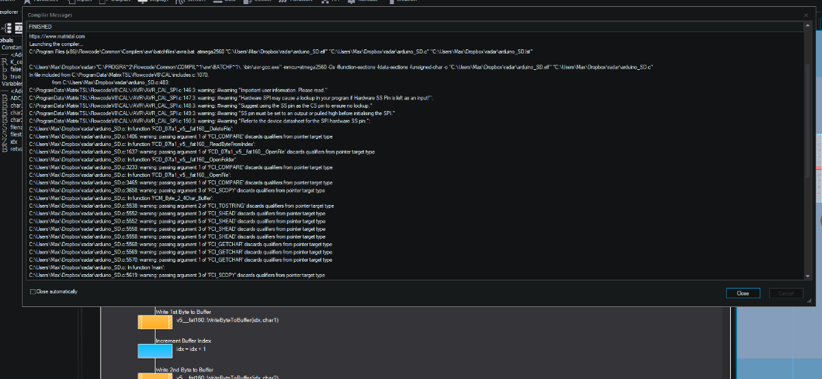

I'm trying to use the FAT component but it gave me many errors at the end of the compilation, I replicated your example (FAT_Data_Logger_Fast on Wiki) on arduino mega2560 excluding the display part but I see that on output it gives me the same errors
I attach files and sreenshot of the errors
thank you

Re: Arduino mega2560 FAT component
Looks like they could just be warnings.
You should see this further down the output, after the warnings...
In which case all should be wellCompilation successful!

Hi LeighM
yes in the end it succeeds, but the program on the hardware freezes in card initialization
