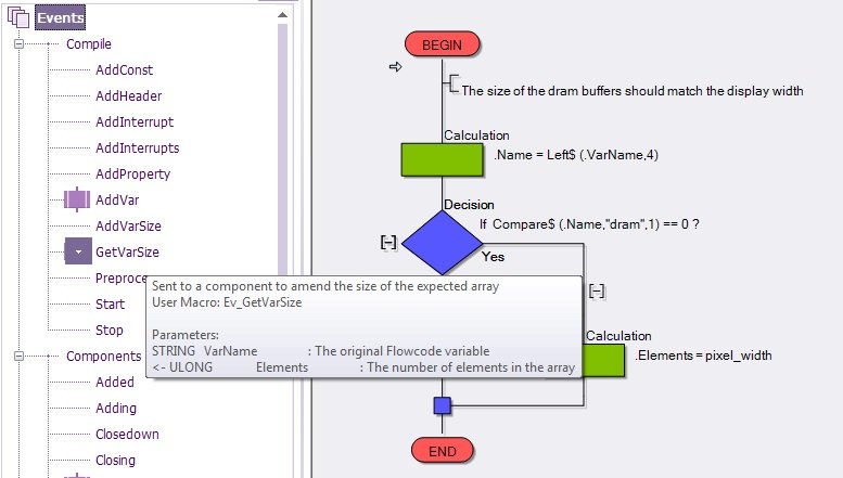

I'd like to check how the 'component' source allocates memory for the buffers for the display..
These are declared as global dram0..7[128] -> but they don't get allocated if a smaller display is defined..
Incidentally - these would be a candidate for a 2d array (see current thread) - which could aid a speed up (Plot and BPlot could be simplified).

Re: OLED with SPD0301 driver
The Ev_GetVarSize macro allows the variables to dynamically allocate the correct size to match the display resolution.

Thanks Benj,
Not quite sure I see how it works - it doesn't look like it does anything? (if (parameter) variable name[0..3] = 'dram' then set a local variable.....) but I'll have a play and see where it leads.
Hi Martin,
The Event macros are fairly mysterious and advanced, I'm not sure I understand them all :D .
The event when enabled gets called for every array type global variable in the component and the Elements parameter contains the number of elements in the array. By writing to the parameter it is possible to override the size of the array in the generated C code.
Note I believe this event only works once you export the code as a component, though I could be wrong on this.
The AddVar event is similar but allows variable code generation to be switched off or completely overridden for specific variables allowing for say a long variable to be converted to a unsigned int or byte as necessary to maintain efficiency.
WS2812 is a bit more complex as its a multi dimension array. So this time we use the Ev_AddVar event macro and override the code generation.
The code check to see if the variable to add is called RGB. If it is then we take the first characters from the code generation minus the last 12 characters.
"MX_GLOBAL MX_UINT8 FCV_06621_LED_WS2811__RGB[32768][3];\n"
would become
"MX_GLOBAL MX_UINT8 FCV_06621_LED_WS2811__RGB"
Then add to that "[" + LED_Count + "][3];\n"
So for a LED_Count of 9 we end up with this.
"MX_GLOBAL MX_UINT8 FCV_06621_LED_WS2811__RGB[9][3];\n"
The Return 1 allows the variable to be added to the C code, returning 0 would remove the variable from the C code.
