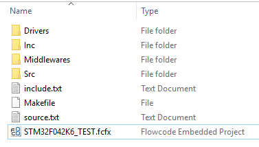

Re: CREATE A USB MASS STORAGE DEVICE USING AN STM32
I’ve hopefully now got something that might help.
The attached updated batch file needs to be copied into directory:
C:\Program Files (x86)\Flowcode\Common\Compilers\starm\batch
Copy any additional code, such as STM32CubeMX generated code, into your Flowcode project directory.
When using STM32CubeMX, choose to create a Makefile project.
Example
Create a file “include.txt” that contains the list of header directories, these can be copied from the Makefile
Example
Create a file “source.txt” that contains the list of source files, these can be copied from the Makefile
Example (The backslash \ can be copied across, or omitted)
These will now be included into the Flowcode build process.
Any functions to be used from these external files can be called from within a C icon in Flowcode.
This might also require a forward declaration of the function by including the relevant header file into the Flowcode “Supplementary Code” dialog.
Example
Example
-IInc
-IMiddlewares/ST/STM32_USB_Device_Library/Core/Inc
-IMiddlewares/ST/STM32_USB_Device_Library/Class/MSC/Inc
Src/usb_device.c \
Src/usbd_conf.c \
Src/usbd_desc.c \
Src/usbd_storage_if.c \
Middlewares/ST/STM32_USB_Device_Library/Core/Src/usbd_core.c \
Middlewares/ST/STM32_USB_Device_Library/Core/Src/usbd_ctlreq.c \
Middlewares/ST/STM32_USB_Device_Library/Core/Src/usbd_ioreq.c \
Middlewares/ST/STM32_USB_Device_Library/Class/MSC/Src/usbd_msc.c \
Middlewares/ST/STM32_USB_Device_Library/Class/MSC/Src/usbd_msc_bot.c \
Middlewares/ST/STM32_USB_Device_Library/Class/MSC/Src/usbd_msc_data.c \
Middlewares/ST/STM32_USB_Device_Library/Class/MSC/Src/usbd_msc_scsi.c
