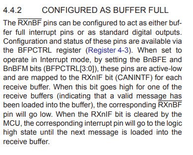

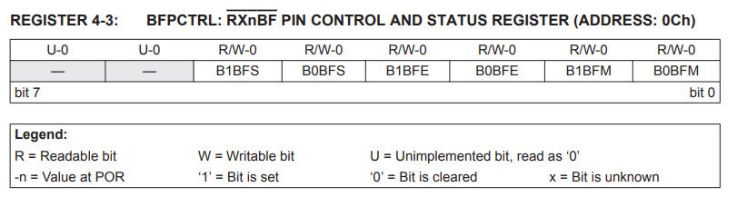

Hi.
The MCP2515 has 2 Pins that can beset to Go low when the buffer has valid data and high when the buffer is empty
RX0BF and RX1BF ,what you need to do is
  • Connect these to pins to the ECIO40P16 IOC pins (Interrupt on change pins)
    Configure from Flowcode Interupt Icon the 2 IOC interupts
    Set the correcsponding registers in the MCP2515 to activate the RX0BF and RX1BF pins (see datasheet) you can do a SPI write to these registers by a C icon how it will function is when the IOC Interrupt pins on the MCU trigger an interrupt you know which buffer has a message and then read that buffer
The issue with the FC CAN Components is that it does not support these Interrupt settings and Error handling of the MCP2515
You will have to use the Datasheet and write C code to help you out unless MATRIX is willing to add this for you to the component
