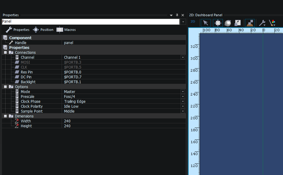

A puzzle: I got stuck at this state - at line 76 there is an empty #define - which won't compile.
Not sure how I managed it or how to cure it....
Any suggestions
st7789.fcfx
(26.37 KiB) Downloaded 341 times
C:\Users\mn_fi\DOWNLO~1>"C:\PROGRA~2\Flowcode\Common\COMPIL~1\avr\BATCHF~1\..\bin\avr-gcc.exe" -mmcu=atmega328p -Os -ffunction-sections -fdata-sections -funsigned-char -o "C:\Users\mn_fi\DOWNLO~1\st7789.elf" "C:\Users\mn_fi\DOWNLO~1\st7789.c" -lm -Wl,-gc-sections
C:\Users\mn_fi\DOWNLO~1\st7789.c:55:10: error: no macro name given in #define directive

I deleted all your macros and all your code and changed the chip to a PIC, but still this error!
There is a strange thing (for me) What is this panel with Pins in your Program even I deleted all?

This problem is related to the "DC Pin" property on the panel. If you edit this and untick "generate a define for the property" then the problem goes away.
Or if you want a define for this property to be added, click the drop-down next to that checkbox and enter the define name and value.

Hi Steve
Thanks a lot. It solved the compiling problem.
In one of my program I had also this panel and I never understand why there are pins, and for what are this pins? a component?
In the 2D panel or 3D panel there are no components. I deleted all......
