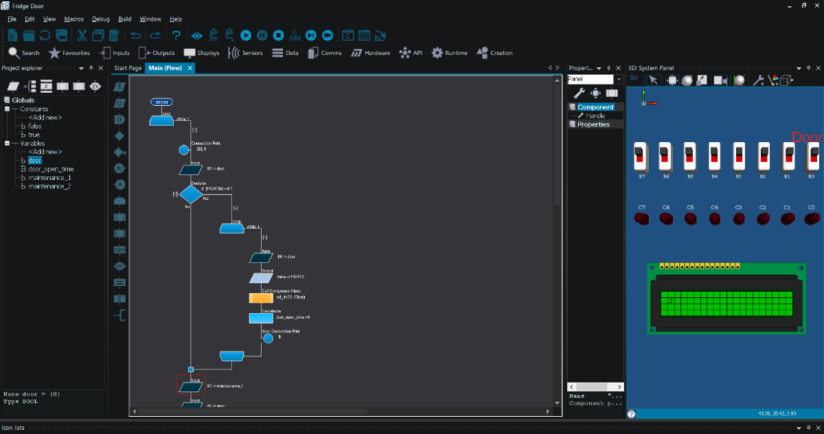

I have an issue with my flowcode code :(
After two loops of working correctly, my B0 stays true, but my code still reads it as false. Any solutions?
Reddit link to video: https://www.reddit.com/r/arduino/commen ... en_though/
Fridge Door.fcfx
(16.67 KiB) Downloaded 160 times
Fridge Door 30_11_2020 18_15_23.png (137.56 KiB) Viewed 1894 times

Hello pedrono_1
You have a microcontroller with 3 ports.
You have 3 major components.
LCD use the portB
LED Array use portC.
Switch Array use the portB.
Please have a look at:
https://www.matrixtsl.com/wiki/index.ph ... _Switches)

My goodness, I feel stupid. Thank you abundantly!
