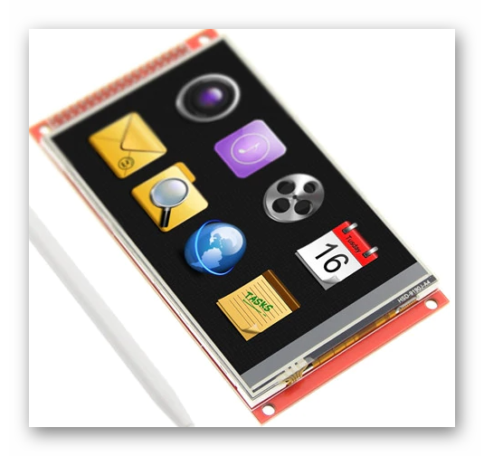

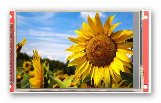

I see nice graphics and images on tft screens
I have a ili9341 spi screen with dimensions 240x320.
how can i create with flowcode v8.
