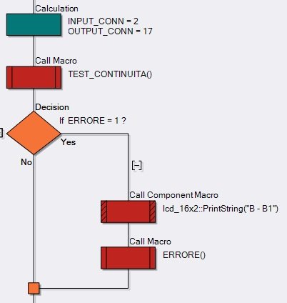

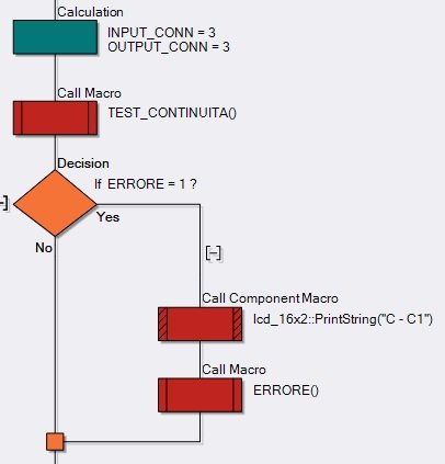

The project should tests the continuity or the isolation between several Input / Output pins over a total of 24 different electrical cables, in order to confirm that the cable under test is correctly assembled and welded. The PIC commands some Multiplexers/Demultiplexers (CD4067) which feeds a positive +5 Volt to one Pin on the Input connector and connect the PIC ADC to one Pin on the Output connector of the electrical cable.
Since the program will be quite long, after adding a small amount of code, I try to compile the program in order to see if I've made some mistakes on the last code added.
If I delete any cable's macro (and the related "marco call"), it correctly get compiled so the issue would seem to be related to memory usage ..
But those errors came out after adding only a small amount of code and the used Program space in the previously correctly compiled program was only 38.6% so the issue shouldn't be related to the PIC's used memory.

Rather then go off into a similar macro for each test I now do the test inside the test macro, the .NumTests = .NumTests + 1 command simply increments the value in the NumTests variable so we know how many steps are in the test.
Here is a snippet taken from one of your macros ported to the new script style
So test 1 would be
Test 2 would be
Etc.
