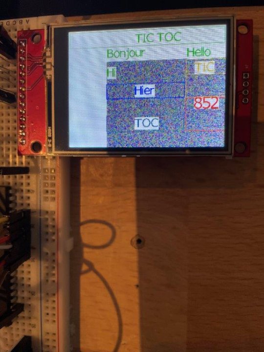

I have a problem with the ILI9341 with F9. There is confusion between the X and Y axes.
The 0 of X1 is -80 and X2 is 240 (80 + 240 = 320)
It also seems that there is a problem with the SetBackgroundColour macro.
I attach a photo of the display and the flowchart

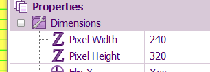

As far I see, you have to swap the with and high in properties for the display.
And you have to use orientation macro and set orientation to 1 (component macro). After this you may again edit your X and Y pos for "print".
