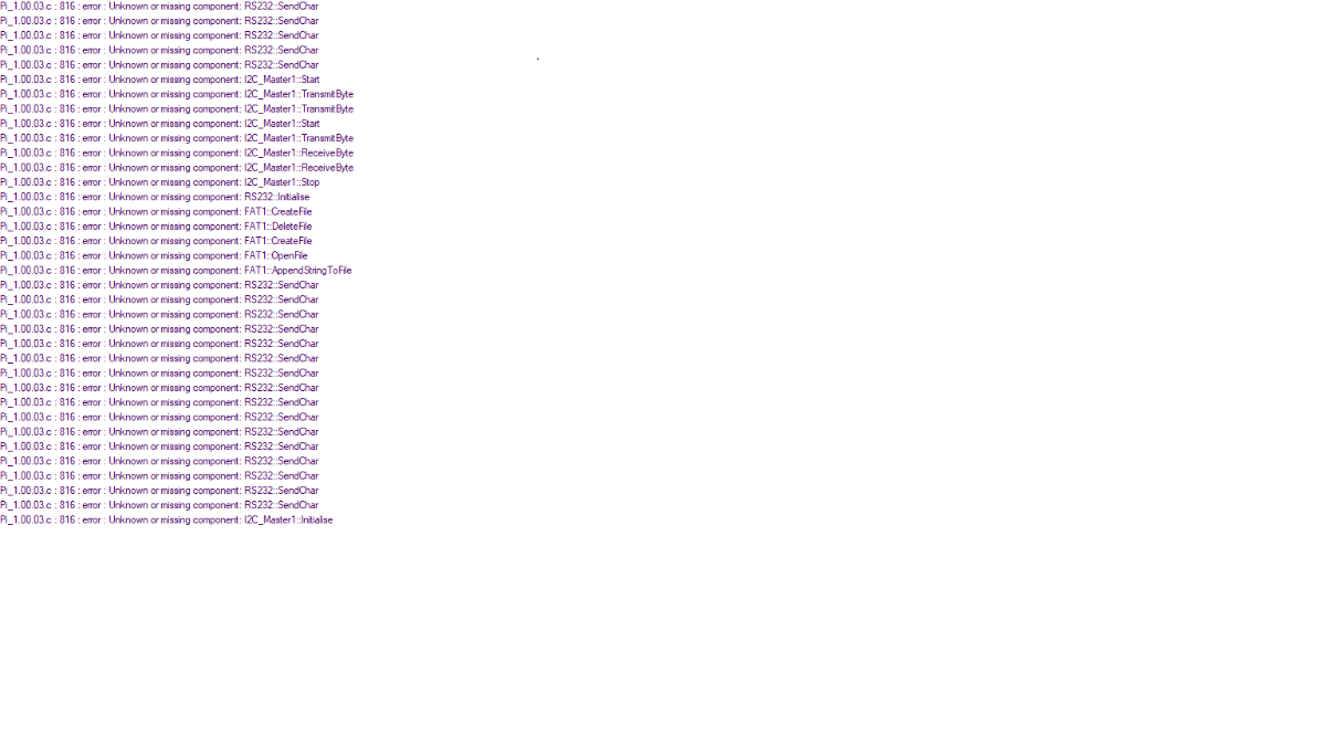

Hello, I am a new user to Flowcode and working with an existing project given to me from another user. I am trying to export to C but I am receiving some "Unknown or missing component" errors. I suspect the main reason is that in addition to the Chip pack that I have purchased, I need to purchase some feature packs for Comms and Storage.
Re: Build to C code
Yes it looks like your project is missing components. Which version are you using and can you use the 30-day trial.
If you load the project into v9 then you can re-start the free 30-day trial and get access to everything.

Thanks for your response Benj. I am already using v9 so your suggestion may not be an option for me.
Re: Build to C code
I can't solve the FAT problem for you but the RS232 and I2C components can be used for free by using the hidden CAL version of the component. It's not as polished but it might enable you to proceed.
