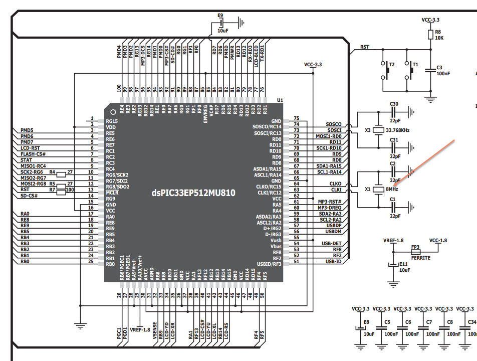

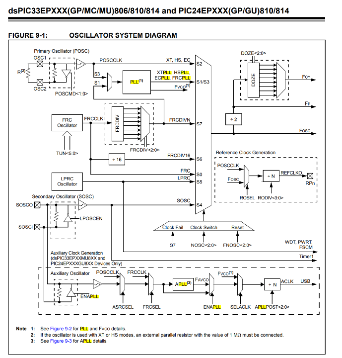

What is the ideal configuration of the Microcontroller, to run at 70 MIPS. Can you show me the configuration?

The board has a 8 Mhz OSCI . You can use this with the PPL.
