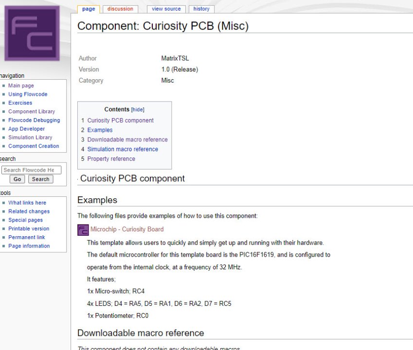

In the wiki there is an example how to use the curiosity board in FC however this morning I am not able to download it
may be one of the MATRIX guys can help is with this
,When I try to download the file Flocode tell me to login don't know why
If your board has a Pickit3 on board you can try to set it up in Flowcode to allow programming as shown in this wiki page
https://www.flowcode.co.uk/wikiv7/index. ... _.28NEW.29
