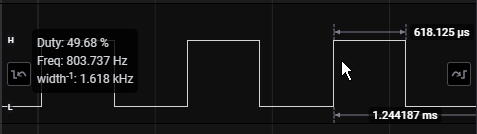

ive made a few changes and tried to measure the output on pin C5 with the oscilloscope but was unable to in simulation do you take it for granted that the PWM box in the 3D display is the indicator that its got something at the output ??

Yes I did as normally if not working the same as sim then could be a pin connection (or a bug) issue.siliconchip wrote: ↑Sat Aug 07, 2021 8:44 pmdo you take it for granted that the PWM box in the 3D display is the indicator that its got something at the output ??
Can you post your changes and I will take a look.

still cant find a pulse on the output using the ICT Function on my board I've changed the target to the 16f 1937 for board testing which allows me to use the e blocks keypad i have, maybe I'm doing something wrong ??, I've checked I've got the OSCCON settings correct with a 1Hz flash test which i have, failing this i may have to dismantle my board so i can get on the output pin with a scope or order a keypad and build a bread board version which i feel i shouldn't need to do as im using the E-block board, ive tried using the flowcode scope as well but again nothing in simulation, ive also deleted the led as i think its pretty much redundant

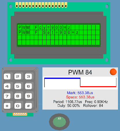

I was posting about it seems to be working for meI set the PWM to 800Hz via the keypad: I have the EB006 & Flowkit.
I can see if I can it it to work for me.

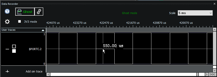

Re: KEYPAD FREQUENCY ADJUSTMENT
Hi Bob,
Tried attached Flowchart for the 16F1937.
The correct frequency is outputted on pin C2.
Keypad is plugged in port D
LCD is plugged in port B
Works with or without ghost.
Display needs a tickle but I used the flowchart for testing.

I have noticed that the frequency does not look correct on the PWM scope within the simulator if the simulation is running at full speed.
I have noticed this when changing from 2000 to 900Hz for example.
This requires reporting as PWM scope only updates to the correct values if the simulation is stopped and restared.
Therefore move the simulator speed slider one notch from the left.
It then displays ok: Is that the issue you are facing?
This is because the oscillator needs to run at the correct speed before Ghost is active.
I have got rid of the extra char on the display and rearranged the panel so it's easier to use.
The data recorder via ITC with freq set to 900Hz: Try with the 19.6MHz crystal and let me know how you get on.
Tesing with ICD/ICT you will need to run the board using the external 19660800 crystal and not using the internal oscillator.
