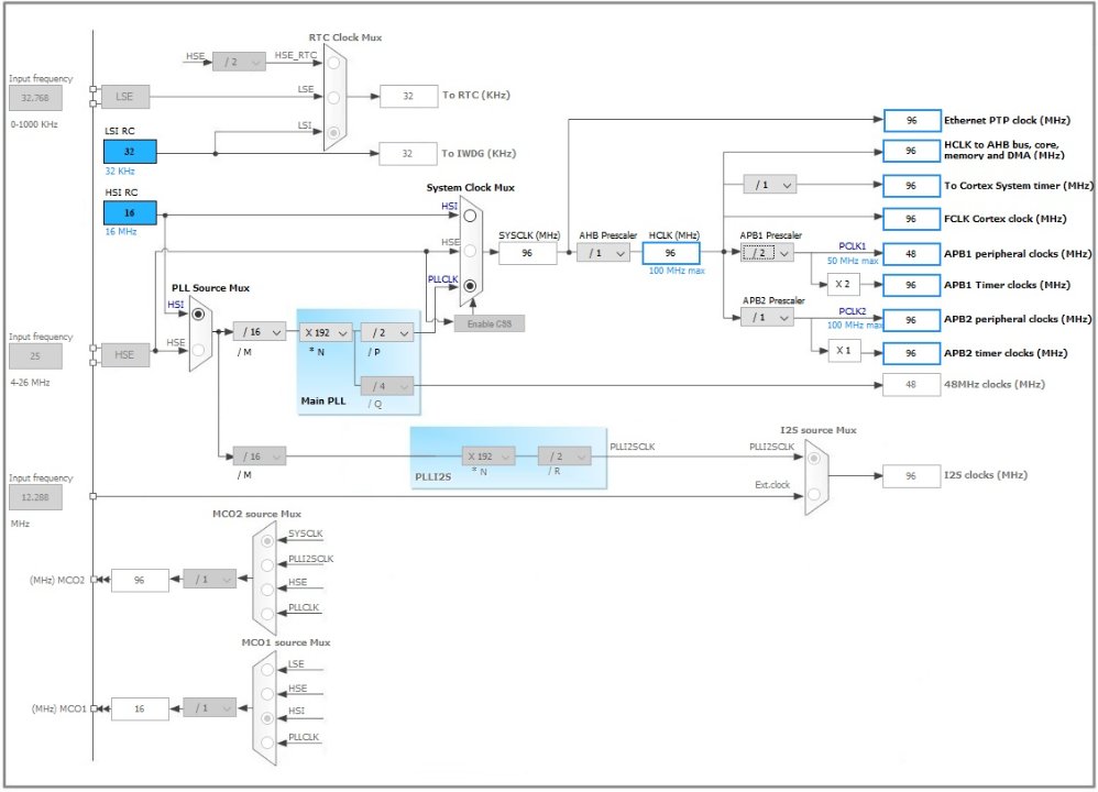

the internal HCLK will be 96MHz, and your APB1 Timer clock will also be 96MHz.
So, for example if you require a 100Hz Timer interrupt, the Interrupt properties should be:
Prescaler= 1:64
Rollover = 15000
The STM32CubeMX application is useful for visualising the clocks, here's a screen shot
Hope that helps
Leigh
