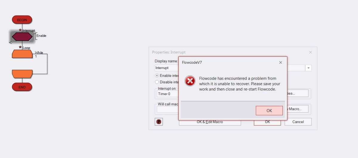

When i use the interrupt icon in the program and trying to configure the interrupt properties i get an error window like below.

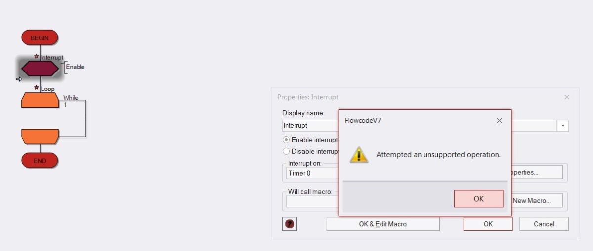

After i select Ok on this window.. another message window pops ups like below.

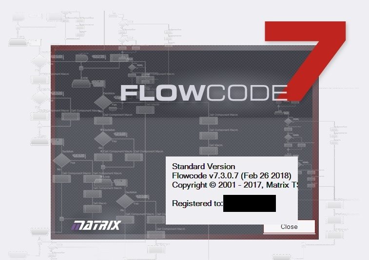

I have used the last suggested patch release for the program as shown below.
