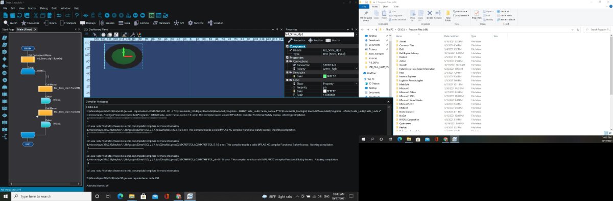

Hi, Im trying to compile a simple test program and I have this error. Can somebody please help.

Please go to the folder of your flowchart and look for the .msg file. Past the contents to a message. Your screenshot is illegible (for me at least).

Hi Kersing thanks for replying. Here is the attachment.

Hi Rod,
It looks like the latest version of the PIC32 compiler may need to be licensed, or at least activated in some way before you can use it.
The toolchain we supply is not the latest but should work well.
If you need the latest toolchain then maybe when installing there are options on if you want a free or licensed version.

Hi Benj thanks for replying. I downgrade the version of installation and it worked nicely.
